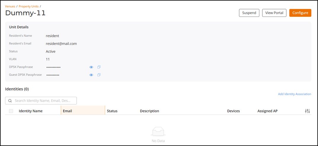

  1. In the navigation bar, select Venues.
    The Venues page is displayed.
  2. Click the Venue name.
    The venue details page is displayed, defaulting to the Overview tab.
  3. Click the Property Units tab.
  4. Click the Unit Name.
    The property unit details page is displayed.
    Property Unit - Details
  5. Click View Portal.
    The resident portal opens in a new tab in your browser.
  6. Click Access Your Portal.
    The resident portal home page is displayed.

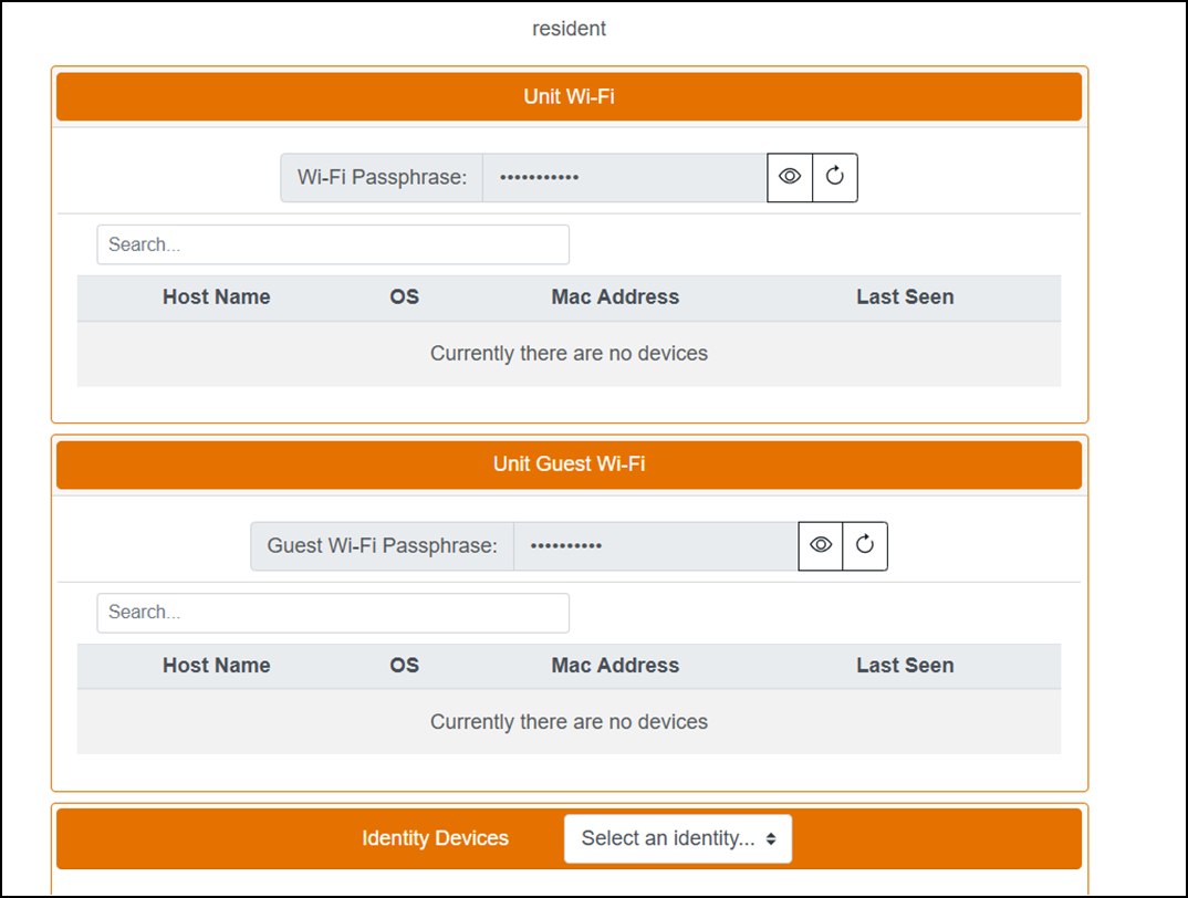

    Note: When Hide system generated identities is enabled for a unit, the portal hides the Unit Wi‑Fi and Unit Guest Wi‑Fi sections for that unit. When it is disabled, both sections appears.
    Resident Portal Page
    Resident Portal Page - When Hide system generated identities is Enabled
    Refer to Viewing Resident Portal Web Page for more information.
  7. Unit Wi-Fi: Click the icon to show or hide the passphrase. Click the icon to generate a new passphrase. The passphrase length follows the administrator setting in the DPSK pool. You can view devices that have accessed the Unit Wi‑Fi network.
  8. Unit Guest Wi-Fi: Click the icon to show or hide the passphrase. Click the icon to generate a new guest passphrase. The passphrase length follows the administrator setting in the DPSK pool.

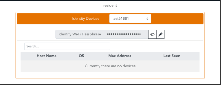

  9. Identity Devices: Select an identity from the drop‑down. Click the icon to show or hide the Identity Wi‑Fi passphrase. Click the icon to generate a new passphrase. View devices associated with the selected identity that have accessed the network.
    Note: Manually associated identities are always displayed, even if system‑generated identities are hidden.
