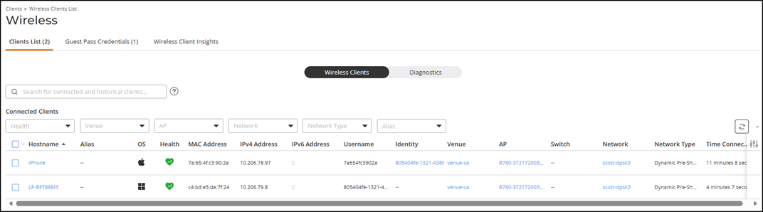

  1. On the navigation bar, select Clients > Wireless > Wireless Clients List.
    The Wireless page is displayed, defaulting to the Clients List tab with Wireless Clients selected by default.
    Wireless - Clients List
    You can download the list of connected clients as a CSV file from the RUCKUS One dashboard.
  2. Review the clients currently associated with your managed network. The following information is displayed:

    You can use the Search option to display only connected and historical clients that match the specified criteria. Select General to search for clients by properties such as Client MAC Address, Username, Hostname, Identity, OS type, IP Address, VLAN ID, AP BSSID, and Alias, where certain properties apply only to connected clients. The search ignores columns that you choose to hide. Select MAC to search using a MAC address. You can enter the MAC address in commonly used formats, including colon-separated (for example, 00:1A:2B:3C:4D:5E), hyphen-separated (for example, 00-1A-2B-3C-4D-5E), dot-separated (for example, 001A.2B3C.4D5E), and continuous hexadecimal (for example, 001A2B3C4D5E) formats. RUCKUS One automatically processes the entered MAC address and performs the search without requiring you to reformat the value. The search field preserves the format in which the MAC address was entered.
