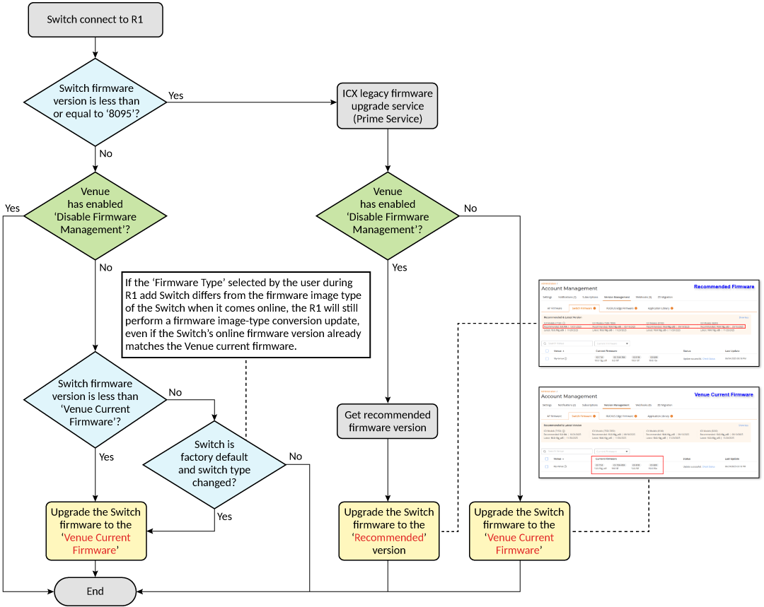

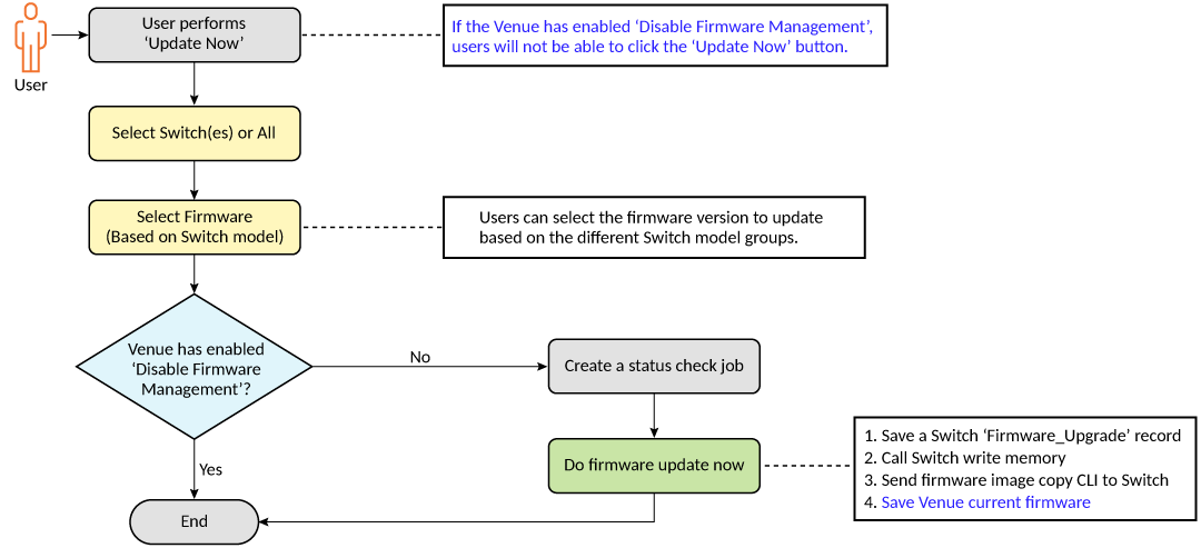

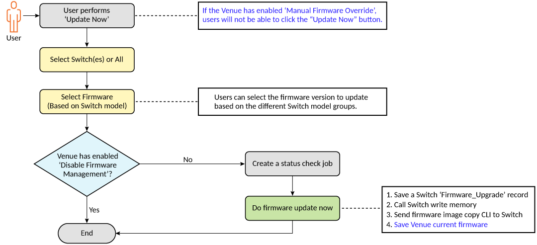

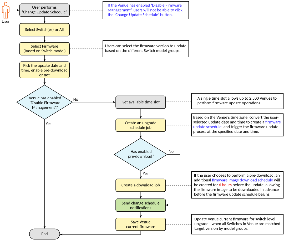

  2. (Optional) Select the Switch Firmware tab to view the switch firmware version.
    Switch Firmware Version
    The Switch Firmware page displays the following information:
    • Recommended Version: Each model base supports a single recommended firmware version. The 7550-24XZP model is an exception and maintains its own recommended firmware version. Click Show More to view the latest firmware version for each model base.
    • Recommended & Latest Version: The ICX switch model number, recommended firmware version for the model, and latest available firmware version with the date of release availability. Note that the recommended firmware version may not always be the same as the latest firmware version. Click the Show less option to revert the display to the Recommended Version information.
    • Venue: The name of the venue.
    • Current Firmware: The ICX switch model number and the FastIron firmware version currently running on it.
    • Status: The upgrade status of the switches. If a firmware upgrade was recently applied, the Status column reflects the result and provides a Check Status option which opens a sidebar detailing the switch name, firmware update status, the firmware version applied, and the date and time of the firmware update.
    • Last Update: The date when the firmware was updated.
    • Scheduling: The next firmware update scheduled. Values include Not Scheduled and Multiple.
    Flow Chart: Onboarding Upgrade
    An icon in the tab name provides a visual indicator when new updates are available; pausing your cursor over the icon displays text stating the same. You can search the list of venues by entering a complete or partial venue name in the search field; all matching venues are displayed. You can filter the venues using the Current Firmware filter. You can sort the table entries by clicking on any table column header; for example, click Last Update to reorder the table entries by the date of the last update (in either ascending or descending order).
    To update the firmware version for a switch, change the update schedule, or cancel a switch firmware update at the venue level, refer to Upgrading Switch Firmware at the Venue Level. To update the firmware version for a switch, change the update schedule, or cancel a switch firmware update at the switch level, refer to Upgrading Switch Firmware at the Switch Level.

  4. (Optional) Set your firmware update scheduling preferences. This option is available on all of the Firmware-related sub-tabs except the Switch Firmware tab and applies the selected preferences at the venue level.
    Preferences
    1. Click Preferences (located above the right side of the table). The firmware upgrade Preferences dialog box appears.
    2. In the Preferences dialog box, select one of the schedule choices:
      • Schedule Automatically: Click Change to modify the preferred update slots.
        Flow Chart: Scheduling an Upgrade
        Flow Chart: Update Switch Firmware Immediately
      • Schedule Manually: You can select this option to manually update the firmware at a suitable time.
    3. Click Save Preferences.
