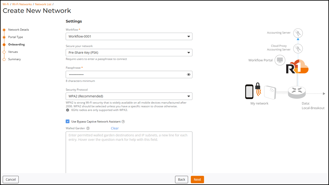

    The Onboarding page is displayed.
    Workflow - Onboarding
  7. Workflow: Select a published workflow from the drop-down list.
    Note: The list includes both published and unpublished workflows.
  8. (Optional) Secure your network: Select a Secure your network method. The options are:

    • Pre-Share Key (PSK): Provides client authentication using the passphrase and security protocol that you configure.
      • Passphrase: Enter a Passphrase (minimum 8 characters) and select a Security Protocol. The options are:
        • WPA2 (Recommended) (default): Select WPA2 (Recommended) and enter a passphrase of at least eight characters in the Passphrase field.

  9. (Optional) Use Bypass Captive Network Assistant: Select the Use Bypass Captive Network Assistant checkbox to enable this option.
    Enabling this option prevents the controller from using the mini-browser on mobile devices. With CNA bypass enabled, portal login is achieved by opening a standard browser to any unauthenticated HTTP page to get redirected to the login portal.
  10. (Optional) Walled Garden: Enter Walled Garden destinations (URLs or IP addresses) that users can access before authentication.
