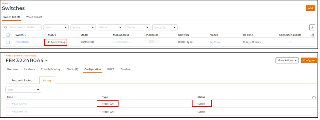

  3. In the upper-right corner, click More Actions and select Sync Data.
    Note: During synchronization, the Sync Data option becomes temporarily inactive; the switch status changes to Synchronizing, and a new entry is added to the History sub-tab in the Configuration tab.
    In the Type column, the entry appears as Trigger Sync, and the Status column shows In Progress during the synchronization and updates to Success once it completes. Refer to Configuration History for additional information about the History sub-tab.
    Sync Data - Switch Synchronization Status and Trigger Sync Record
