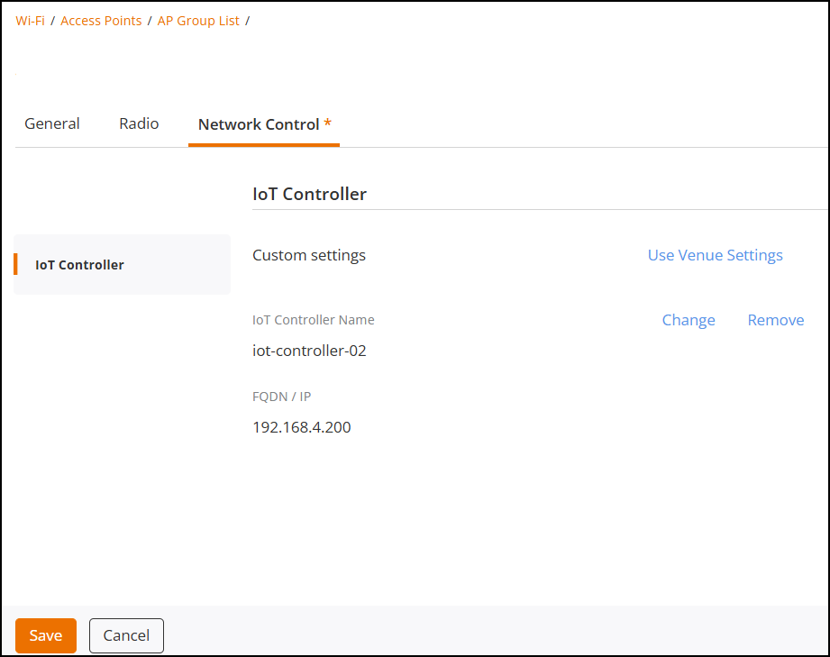

  5. In the IoT Controller settings the GUI indicates whether the AP group is using the venue settings or custom settings
    Note: By default, the venue-level settings are applied.
  6. Click Customize to override the settings.
    Configuring an AP Group with IoT Settings
  7. Click Associate IoT Controller to associate an IoT Controller to an AP group.
    The Associate IoT Controller sidebar appears, displaying a list of available IoT Controllers. Select an IoT Controller from the Associate IoT Controller list. You can also click the Add IoT Controller option at the top-right corner to add a new IoT Controller if it is not listed. Click Apply. Click Save to apply the IoT Controller custom setting.
    A message appears at the bottom right of the screen to indicate whether the IoT Controller was successfully associated or not.
  8. (Optional) Click Change to select a different IoT Controller from the list of available controllers. Repeat Step (7) to apply new selection.
    Note: The newly associated IoT Controller will automatically replace the existing one.
  9. (Optional) Click Remove to remove the associated IoT Controller.
  10. Click Save.
    A message appears at the bottom right of the screen to indicate whether the IoT Controller was successfully disassociated or not.
