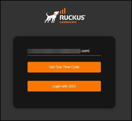

Logging In Using the SSO Option
After setting up the SSO and creating the SSO Groups, the user who is a member of the SSO Group can log in to RUCKUS One using SSO with their Email address. The user will be redirected to the Active Directory where the user can use the AD credentials to seamlessly log in to RUCKUS One after successful SSO authentication.
