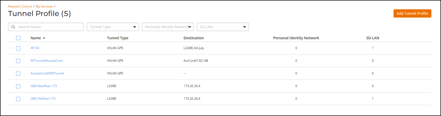

  2. In the My Services page, click the Tunnel Profile tile.
    The Tunnel Profile page is displayed. The Tunnel profiles are displayed in the table. The Name column displays the Tunnel profile names, Tunnel Type displays the tunnel type used for that tunnel profile, Destination displays the tunnel destination, and SD-LAN displays the total number of SD-LAN services configured to use this tunnel profile.
    Tunnel Profile Page

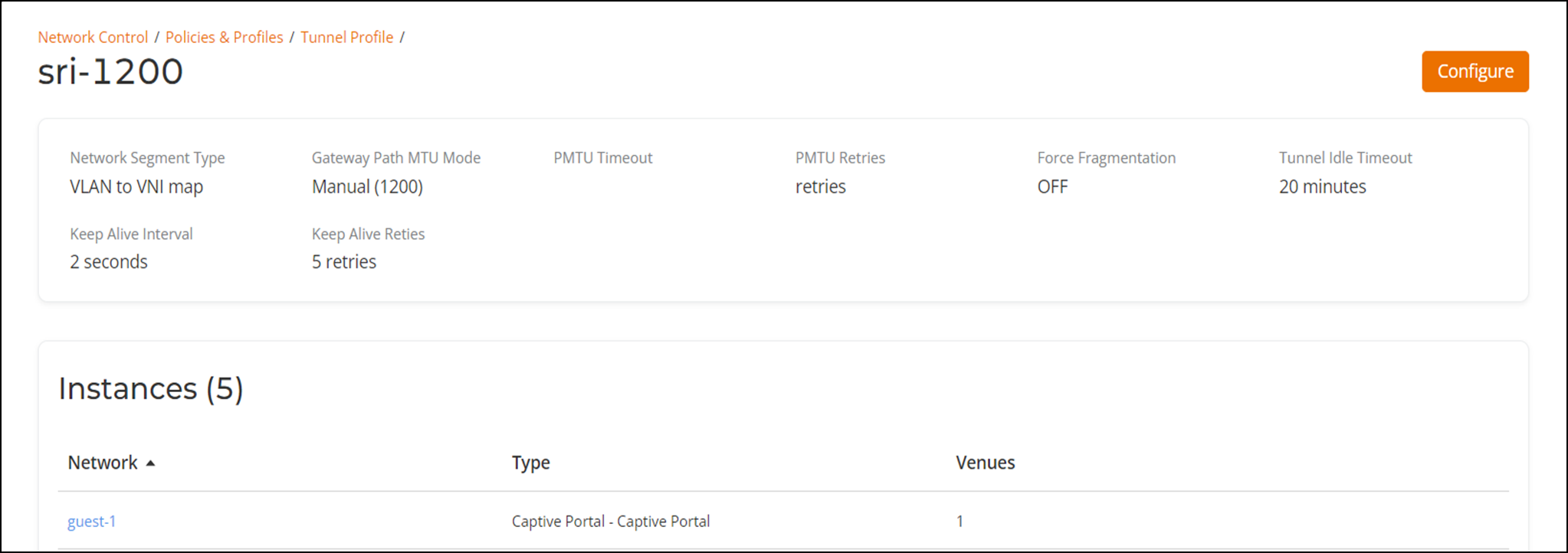

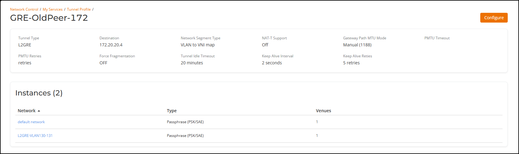

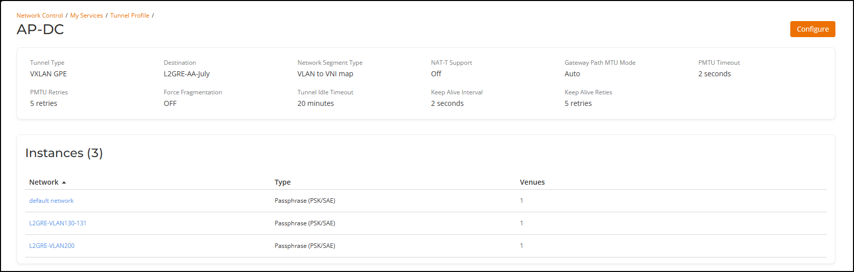

  3. In the Name column, click on a specific tunnel profile name.
    Detailed information is displayed for the selected tunnel profile, including the tunnel configuration settings and the network instances with which the tunnel profile is associated.
    Details Page for a L2GRE Tunnel Profile
    Details Page for a VxLAN GPE Tunnel Profile
